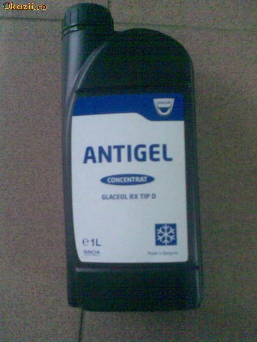

ovidiu87
post 22 Dec 2010, 21:57
Posts: 593
Joined: 18 March 08
From: Resita
poate or fi gresit eticheta la bidonul tau(75 in loc de 57)
in rest toti avem altceva !
Uite aici poze cu bidonul asta, si pe spate si pe fatza , unde scrie 75 ?
This post has been edited by ovidiu87: 22 Dec 2010, 22:02

alindrgn
post 22 Dec 2010, 22:00
mamut lânos
Posts: 1.347
Joined: 27 April 08
From: brasov
This post has been edited by alindrgn: 22 Dec 2010, 22:15

DMP
post 23 Dec 2010, 09:34
Mumu' padurii
Posts: 1.670
Joined: 4 September 06
QUOTE(alindrgn @ 22 Dec 2010, 21:54)
LE: despre asta vorbesc.
DA.
Si doar iti pusese cineva mai sus o poza de pe spatele bidonului de Glaceol Rx Tip D.
