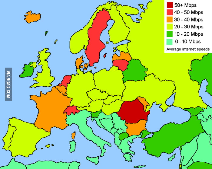

post 9 Jan 2016, 22:16
Post #1130
Stăm beton la orașe. Ploiești, Ieși, Copitala, Temesvár, Galaț.
This post has been edited by Markos: 9 Jan 2016, 22:19
iulia_boris
post 9 Jan 2016, 22:54
Post #1131
Posts: 434
Joined: 17 September 10
Mai precis..
Dacia Dokker Laureate 1,6.. 2016 - B 696 BUL
Cu cat cunosc mai bine oamenii, cu atat iubesc mai mult cainii.
post 9 Jan 2016, 23:00
Post #1132
